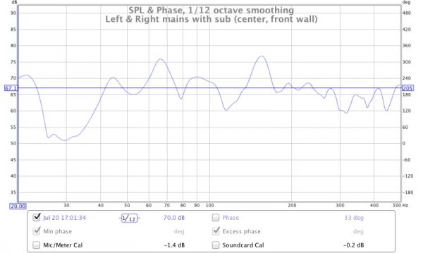

As the null in the sub graph overlaps the null with the main speakers it is not helping at all to solve your null problem. My personal advice at this moment - put the sub on a platform with castors and move it along all the length, taking measurements each half meter. You will get a better understanding of your room.
Considering that the wavelength at 32 Hz is more than 10 meters, IMHO the sub should be far from the mains to help filling the mains null. I would consider putting it between the listener and the back wall, and then play with phase adjustment.

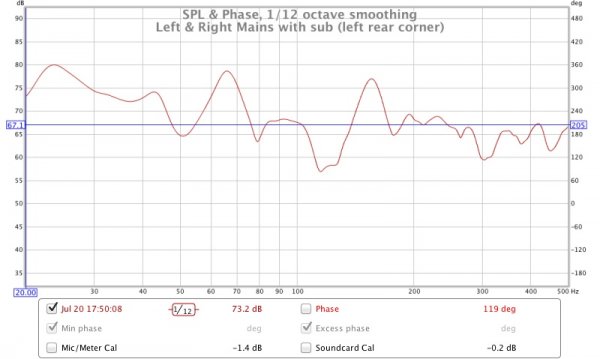

Was able to move the subwoofer and measure the effects. Tried ~1/2 the distance up the long wall (12 ft from front wall) with the woofer firing into the center of the room. No substantive change. Previously tried the sub in both front corners of the room. Again, no significant change.
As recommended here, moved the woofer to the back corner of the room. This had a big impact on the null- in a positive way. See the graphs below.
Lots of tuning and treatment left to do. Still, a nice improvement.
Not sure if I am hearing the location of the subwoofer. Sometimes I believe I can tell it's firing from one side of the room and that it is not symmetrical in its effect. Perhaps trying to sort out the psycho-acoustics from 'reality'. Need to do more listening. Oh, the burden. :)
Before:

Good progress. Given the results, it seems like the null was created due to interaction with the mains. In that case, changing the delay on it may have equiv. effect. Try adjusting that and see what happens.
Can’t say I’m surprised. You’d be surprised how often corner placement eliminates problems like you had. I’ve helped countless dozens of people deal with their subwoofer response issues over the past 15 years or so, and I can probably count on one hand the number of cases where corner placement resulted in an unusable response curve. All that’s needed now is to apply a little parametric equalization at 50, 65 and perhaps 23 Hz, and you’re done.

Indeed it's a good change.
I don't think the OP has ability to delay the mains or sub...most two channel systems don't unless they are using a DEQX, Trinnov, computer with multichannel soundcard, etc. For optimal integration you REALLY need the ability to delay.
Still though there are some big swings in the bass. I like to aim for keeping the response at 1/12th within a 10dB window. It's pretty difficult but not impossible to achieve in the context of an audiophile two channel system. Normally SBIR is the thing that screws up reaching the target...
