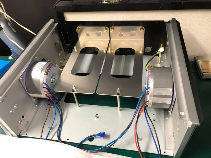

SOULNOTE's new models appeared, as trial version.
Top left: D-3, new DAC
Top right: Z-3, ZERO LINK transport
Middle left: X-3, clock generator
Middle right: P-3, preamp (has released)
Front: two A-2 integrated amplifiers (have released)
The new 3 models, D-3, Z-3 and X-3, are going to be released in July.
I will report as having a chance to listen them.
New monoblock power amp M-3 is planning to be released in November.
