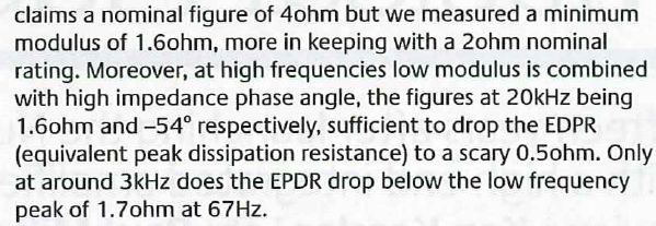

Just to illustrate - what will audiophiles conclude from these words?
That the speaker is a bitch to drive and should be avoided (?).

The picture with the quoted text comes from the HifNews review of the Magico S3, an excellent sounding speaker that got great reviews ... :eek: Just posted it to show how misleading can be such brief and hasty appreciations!
And also to remember that it is not only Wilson that has a trend to low impedance speakers - most manufacturers do it because most modern amplifiers have no problems driving them and is a way to increase sensitivity of the speaker. The concept of EPDR was introduced long ago because of the SOA (safe operating area) of power transistors - and then became fashionable in audiophile techno-jargon.
Yes, I know tubophiles are not happy with such low impedance!
