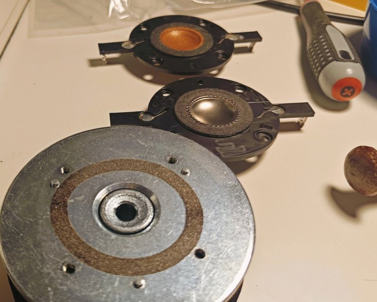

New Wilson Inverted replecable Focal tweeters have now a new rubber surround, last very, very long.

Thanks very much for the photos JR...they look substantial. Have you heard them?
Funny, but I just spoke to Jerron at Wilson yesterday and he thinks they are an upgrade.
You also need to replace the tweeter resistor that comes with it.
Millersound did a great job with the repair but I wonder if it remains within Wilson specs.
I'll get a new pair of tweeters and report back.

I'm electronic repair tech and I've repaired many Focal tweeters..which are very very nice sounding indeed. Report your findigs with you new tweeters.
