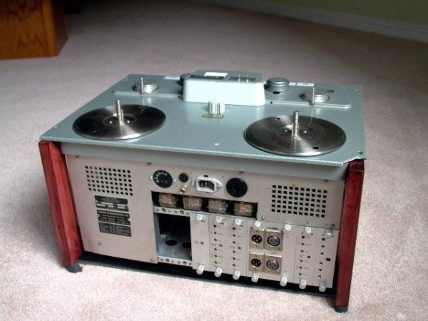

Since to play with R2R two years ago, have not look at vinyl, cables amps anymore, my crazy friend who like to play game on Ebay, whatever Telefunken, Studer in good price, he will go for them and he just bought a Studer B62 from England, but the packing was very poor,carton box was broken when received, you can see from pictures, the top plate lost a piece, and the one of the repro amp's lock missed and the worst thing is it can't work,
B62 has a old style mechanic transport control by relays but with same amps of A80, if it can work again that can compare with A80 to see the mechanical difference will effect to the sound by how much. thank to this happening that I got a chance to learn how to fix the problem of B62
lucky there are two more locks just for use of covering empty space that I can use for to replace the repro amp's missing lock plate but need to drill holes for calibration ,
the seller said it is on working condition but I don't know what cause the problem , after spend a week to study those relays' operating, I found out 3 points were unconnected so now it is back to alive again with the cost less than 1K$ it is not bad, I will tell the result after compare with A80

RogerD
May 23, 2010
3,734
319
565
BiggestLittleCity
Hi Tony,
What a beautiful deck and a shame that it was damaged in shipment. Shipping damage is anybody's worst nightmare and because of that possibility I crate and foam these RTR's. I'm going to say prayers and cross fingers when I have my MR70 shipped.
Can the piece be welded or epoxied back on? do you have it? Makes me sick.

Hi Roger
That piece already gone somewhere in the way from England

This B62 old machine not only damaged in shipping, it's mechanism and electronics also in problem, In the day it landed with a broken box, body was hurt, when power on, only one indicator works (4 there) and function completely dead, after fixed to make it run again and sing but found heads need relap, tension control are not normal , also recording not working too, the record amp look like OK but the EQ card ( come with CCIR only ) is in wrong value resistors and reverse position of 7.5 vs 15 of speed, I don't know who make that wrong, Studer or last owner, anyway I made a correct NAB EQ card for it already, still can't record because the oscillator card doesn't work, if the coil is done that mean need another card for it, not easy to get that spare part of coil, after checked the coil's terminals , no open circuit, problem is not there, then I replaced all transistors, still not working, after I looked at the A80's manual ( same circuit) there were marked dc voltage on each stages but B60'manual didn't. then I found a little Tantalum cap is short circuit, that you can see in the picture I put it beside a replaced bigger cap, usually Tantalum cap is a solid type's cap no solution inside, short circuit is first time to me. now it can do recording, but I am still wondering what will be the next problem,

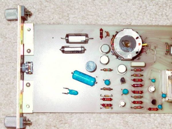

I recently bought a B62 ,mainly to add to the collection as i do not care for its looks. What a delightful surprise this machine has been. As it shares its electronics with the early A80R I expected it to sound similar but somehow less accomplished. It does not sound anything like the A80,having a much more lively and upfront presentation-a true Rock and Roll machine. I could immediately see why John Lennon so loved his. It has that same open crisp sound that characterised the Beatles' sound.
Swapping cards between the 2 machines the A80 has a relaxed huge rock solid presentation that the B62 cannot match while the B62 fires darts of sonic information. Somehow I keep expecting it to sound harsh and bright but it never does
I guess the main difference is the different heads, even at the same machine A80, just change the head to the butterfly head with the same amp will sound different too
