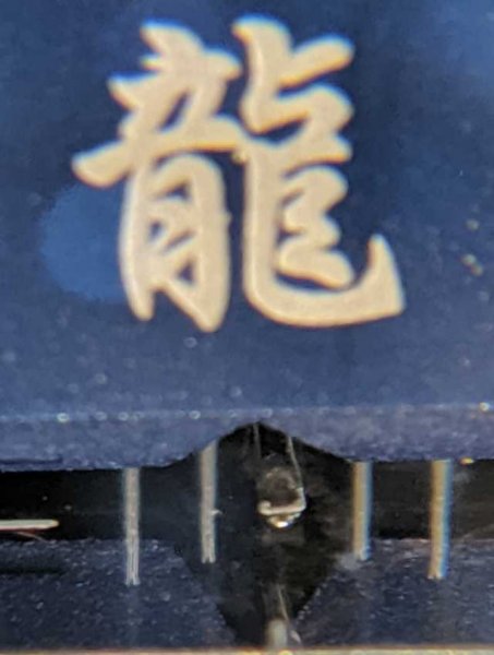

During alignment, I noted that this demo cart probably has a compromised suspension. The cantilever is visibly askew. I was able to compensate and get things very close, though if this were a newly purchased cart, it'd be rejected. I don't know what kind of prior (ab)use this one has seen, but I hope this isn't a sign of any lack of mechanical robustness.
The above photo shows the cantilever prior to my compensating adjustments. After aligning the cart and some rough by-ear tweaking, I pulled several LPs to begin real listening. By default, I like to use the Kuzma periphery ring on my Stabi M platter, even with flat records, but I noticed that the Blue Dragon was riding too low. The body of the cartridge actually rests on the lip of the periphery ring when the stylus is in the lead-in groove and well into the first track on the LP. I do hope this is abnormal, and maybe a symptom of the suspected suspension issue. But for this demo, I either can not use the periphery ring or I can not listen to the first track of LPs. Ugh.

My company played the first Top Wing Red Dragon cartridge to Rocky Mountain Audio Fest a few years ago. We also had a few samples/prototypes and they all exhibited the same symptom of what you describe as follow :
This happens when the cartridge has been stocked on the side. The damper used with the Top Wing cartridges is silicon based and very very soft so it alters easily . This applies also with wrong geometry applied, non properly set turntable levels, etc...
If not too severely bent (or banged) the cantilever should get back in original place once the cartridge is resting in a "normal" position.

Thanks, @Cala . However, I did have the cart resting in a normal position (albeit upside down) in the box for three days before getting around to installation. So. I'm not sure. It actually looks like it has previously been used without anti-skate, causing the cantilever to get pulled off center. But again, I'm not sure. I think before returning the cartridge, I'll re-check its alignment to see if it has changed.

The askew cantilever looks familiar. Your description on sound seems to resemble how I described the red one.

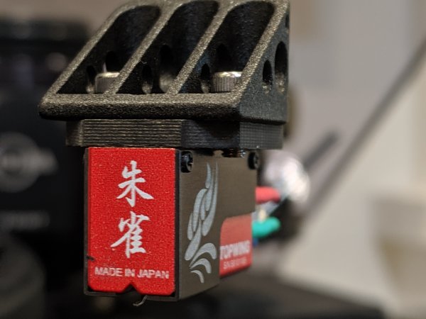

The red sparrow has landed. This cart also rides too low to make use of the Kuzma periphery ring. Listening impressions to follow.
Reactions: howiebrou
