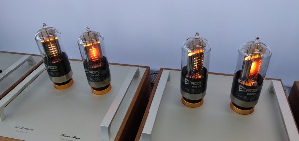

The valves at Munich.
One thing. The Psvane Molys were reviewed by Kevin Fiske in Hi-Fi Critic magazine. He owns an Audio Note Tomei and has ELROG 211s.
I know him and talking to him he really rates the Psvane Molys. He was urging me to buy some.
Another thing. Audio Note at Munich were using GEs. Go figure...;)
Reactions: bonzo75

Look at how hot those Molys look to be running in my pic.... the plates are glowing massively.
