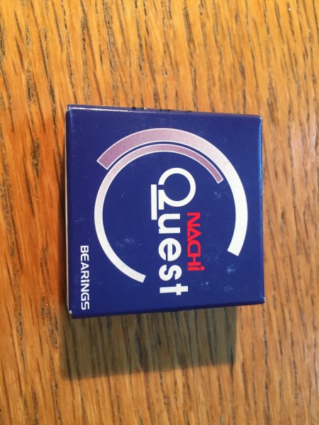

I tried to use NACHI ABEC-5 bearings to my Telefunken M15, Nagra 4S, Ampex 350. And Abec-5 was more noisy then standard SKF bearings !

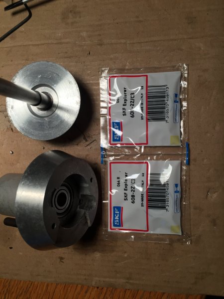

I put SKF bearings to my Ampex 350 tape stabilization roller, working quite silent. IMG_3776.jpg

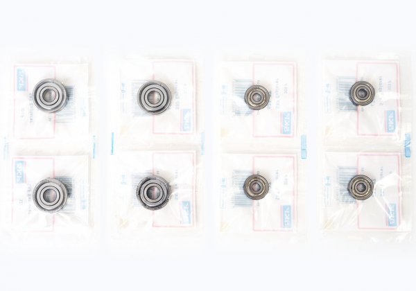

Lets look what this guy is selling. On picture possible to see that is the same SKF bearings :) Price for 1 bearing in Europe is 3-4 EUR. _DSC5358pp-copy_edited__24468.1575551055.jpg
