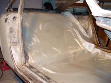

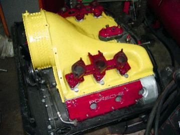

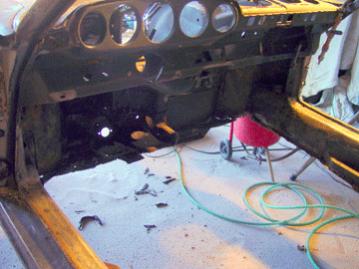

and by the way, George, one of Roger's daughters is an architect in SF and he is in the process of restoring from literally the ground up, a 1972 Porsche. small world, eh?
as it arrived, the kid in picture (on the left) is who Roger hired to do the tear down and get ready for paint work. This also gave an unemployed teen some work through the winter. It came from Detroit from a guy who bought it to restore it and race it, but never got around to it, so he towed it and the new racing engine that he had done for it out. lots of rust, Roger had the kid cut out the entire bottom of the car and replace it all with foam and fiberglass. Roger has taken off over 800 lbs of weight so far and continues to customize and machine parts as needed. the colors are yellow and maroon. almost ready for paint.
