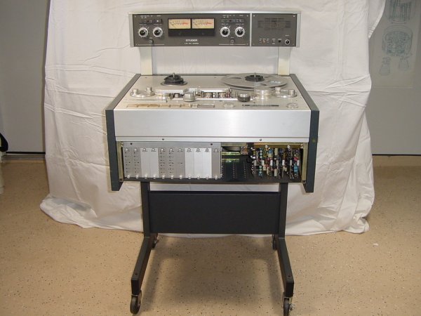

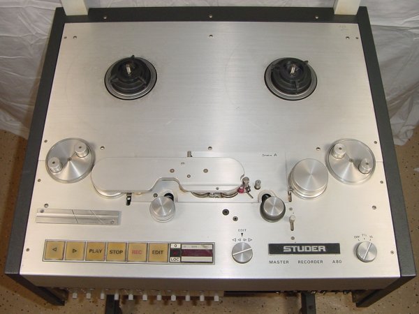

Here's some studer porn pics of the first one....1981 A80 RC Mk2 with only 550 hours on the counter. One wasn't enough however so I got another one with rebuilt spooling and capstan motors along with a JRF Magnetics repro head. It will also have XLR's outs for running into an external pre like a Doshi for example. I'm not sure where they will fit yet...LOL

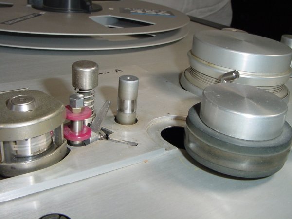

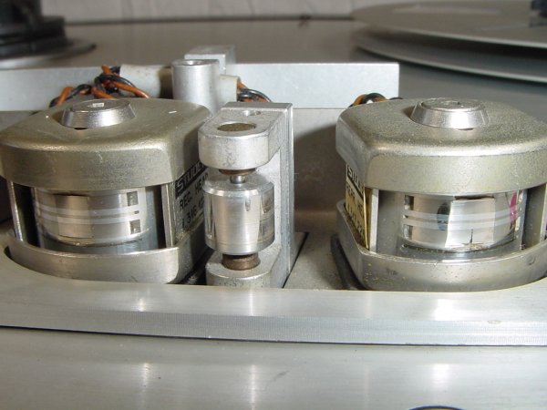

Not meaning to put a damper on anything but do you think this machine has only done 550 hours. The playback head gap is open and the capstan shaft looks pretty polished. Perhaps the seller typo'd and should have put 5500 hours?

The face plate says A80 RC....is it supposed to say Mk2 also ? I am having my friend Bruce B look into the matter to see if there is any truth to this. I have not paid for the auction as of yet. The counter on back does say 580 if you enlarge the pic enough. I suppose the meter could of been reset. If it's only the head wear (maybe the headblock was from another machine), it can easily be rebuilt with better heads...JRF, ect.

somehow I missed that. If the headstack is an old, very used one from another machine (which it appears), no big deal. I can have it rebuilt at JRF. My concern are the bearings in the motors and tape tension guides and rollers and of course capacitors.. The machine looks like in pretty good condition although the capstan shaft appears to have more than 580 hours of use. I just don't know what to do. Maybe I don't need two machines anyway....hmmm

Well after some investigation by our own Bruce Brown, the unit is not an RC Mk2, it's the older RC. I also got a pic of a capstan with 1000 hours on it and this one looks way more worn. The hour counter must be broke. Since the unit is not as described in the auction and the seller does have a 100% satisfaction/return policy. I am going to cancel the deal. Pity.

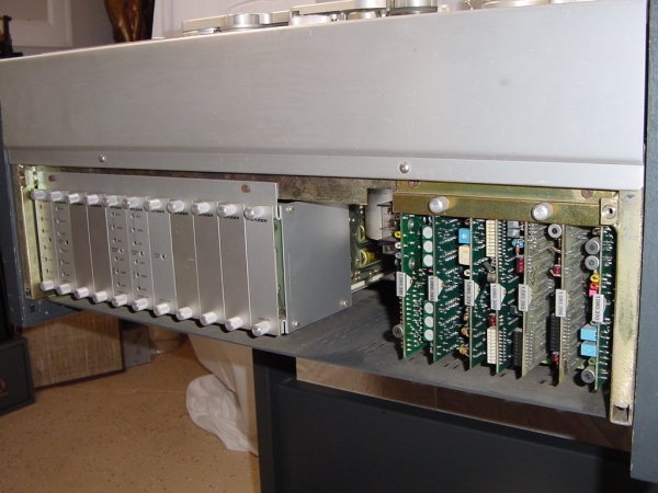

3) There are many transport control and audio card revision differences between the two. If the boards are all original, one can visually identify an old A80 transport cards by adjustment pots with round face metal casing and Mk IIs having square plastic kind. Again the board could have been replace (as found on Spooling Control card in the eBay machine that must have been replaced at one time). In the audio card racks, you can tell first by looking at the Oscillator card. A80RC has only one 1/8" DIN Erase current connection on the faceplate of the Oscillator card and most MkII has additional four yellow LEDs for various status indications (could vary widely with different configurations - stereo/mono, etc). Of course there are major differences in audio cards and audio power supply boards. As I had mentioned elsewhere, there are two different discrete audio "opamp" modules and beefier audio power supply found in Mk II.

7) Capstan - brand new capstan or one that was reconditioned have mat finish with same color all through out the shaft. I personally don't think mirror finish from normal use isn't all that bad as long as it pulls the tape properly. The Nagra T's have its entire capstan in mirror finish including tape contact area. On the other hand, if the wear is too deep to be felt when one runs finger nail across, it can't be good.

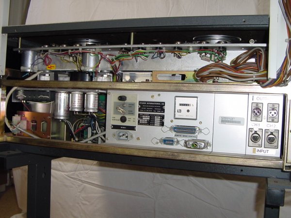

8) Runtime meter - its main use is to estimate the head use hours (IMO) and can't be the ultimate indicator of the machine's actual age. It can be disconnected, even wired in reverse to get younger as it gets more use (as recommended by Sony for their APR5000 series machines) and could run completely over and reset (more than likely what had happened to eBay machine)
