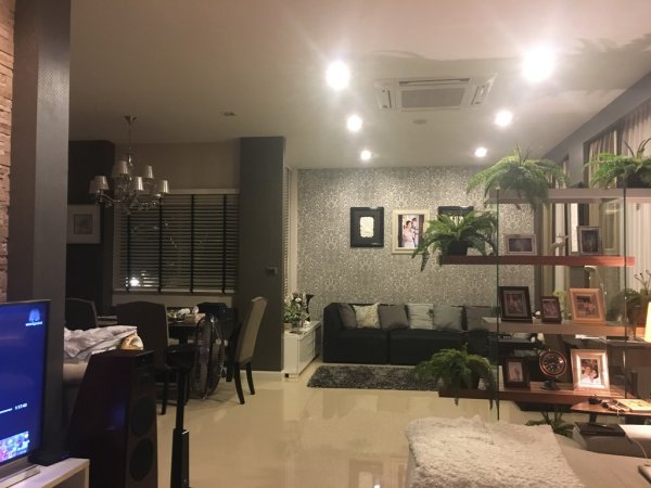

Just to give you an idea this is the living room/listening room. At the far end is the blank wall with windows either side. Behind me where I was taking the photo are glass sliding doors. The recess on the left might throw the focus out a bit..not sure. It's pretty much open-plan. The far wall is 4.5m wide. The living room is 15m long.

The Martin Logans are are going to be airy alright, but at the expense of attack at times. 3D imaging should be excellent with M/L as long as you don't move your head more than six inches either way of the sweet spot.
Acoustics of your room will be challenging for any speaker, but I'm a M/L fan and would just deal with it.
