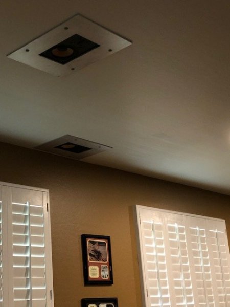

Dave, your room has gotta be one of the absolute worst in terms of planning the best home theatre sonics (which you readily admit that you have these limitations) given its a super long room, open, living room on one side, kitchen way on the other side, open wall area just past the living room sofa, shutters on the left side (non-open wall to the outside), etc. With young kids and dogs, you have a large entertainment center, with a 77" Sony OLED, components in cabinet below, center speaker above tv in cabinet, main floorstanding left and right speakers just off and next to the cabinet, on the left a large subwoofer right next to the speaker, on the right a stand right next to the speaker, with front left and right speakers perhaps a foot if that in front of the wall. 9' high ceiling. All of your speakers and subwoofers are old, 20 years, built by a great local company (Marcelino) now no longer in business (too bad - they made great sounding speakers). Your 7.1 system has four in ceiling speakers for your side and rear surrounds. No acoustics treatments! See below photos of theatre portion of the long long portion/great room of Dave's home!

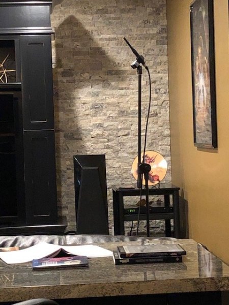

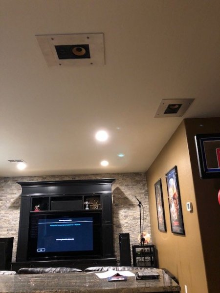

Then we did the Room Perfect optimization. You are supposed to take a number of measurements. First from the main center listening position. Then from various random positions, heights, microphone orientations around the room. Random measurements no closer than 1.5 feet to side walls and 3 feet to front speakers. The onscreen display perfectly leads you through the optimization steps. If a measurement has an issue with volume level it tells you, and you reorient the microphone and stand and try again until there's no issue (Trinnov is similar in this respect). The on screen display tells you the percent of optimization achieved, and you are supposed to get at least 95. We did the "focus" main center listening position, and then I think 7 more random measurements. Then the manual states to do several more measurements but within 1.5' of side walls and also ceiling. So we did 3 more measurements randomly again to accomplish this. Then the MP50 did the optimization calculations.
