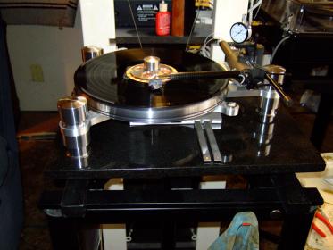

Here are some pictures of my Oracle on a modified Lead Balloon stand:
Sparky
