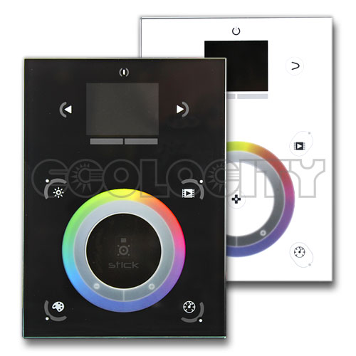

I have halogen lighting when doing set up stuff but normally they are off when listening. For ambient lighting I went with LED RGB rope lights. DC is fed to them via power/control boxes. One box for every 20 feet or so. These are DMX units that are synched up with a master DMX controller (Stick) that is mounted on the wall above the bar.
With a laptop, you can program any number of scenes. 7 scenes can be saved on the controller's internal memory.
