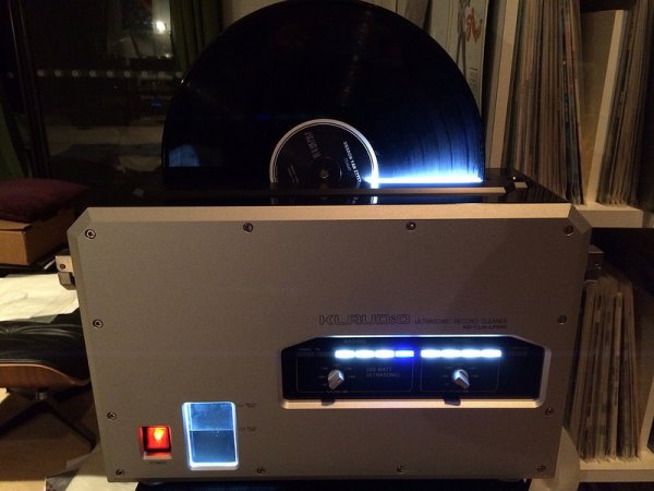

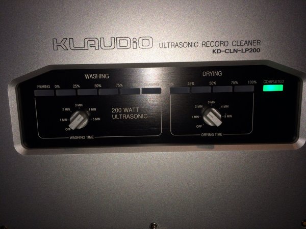

Just picked up a KLA from a buddy of mine who is getting out of vinyl for a while. less than 2 months old. thanks bud :cool:
Seems they are up to version 4. No toggle switch, just 5 speeds and off for washing and drying. A nice cool light in the right side lp slot. Not sure what other improvements have been incorporated

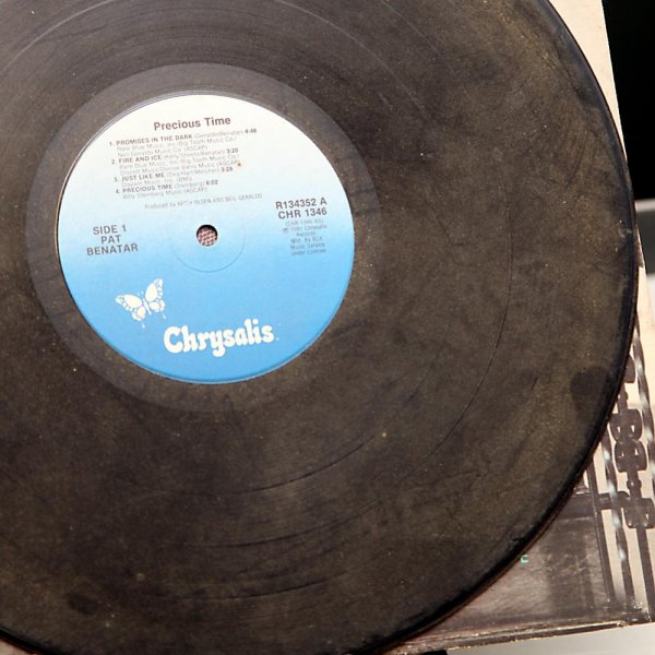

I wanted to check out how the Klaudio does with really, really dirty records, and I finally got the opportunity when I picked up something that looked really bad.
I was going to change the water in my cleaner anyway, so I didn't mind putting this album in. Here's what it looked like before cleaning.
I ran it through once on 5min clean, 3 min dry and this is what it looked like after.
I didn't play it to see what it sounded like before cleaning (I'd probably would have had to throw away the mat and the cartridge), but after the first clean, it still sounded pretty "sandy".
I changed the water in my machine twice, and cleaned it once more. Still sounding bad.
Changed the water once more, cleaned it twice more, and it's sounding pristine. However, there's still the problem of the really dirty label and dirt in the end part of the lead-out groove.

Interesting Gary. I think I will use my normal RCM first to get rid of all that dust and crap.
seems to match my limited testing that two goes with the KLA is better - perhaps more :D

Since I didn't know what all that dust and crap were, I didn't want to risk getting that crap on the platter/brushes of my normal RCM. I thought that the Klaudio's tank might be easier to flush.
