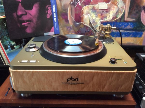

Just like this DD table from PBN AUDIO. Once it reaches speed (almost instantaneously) it stays locked in at 33.335, and never moves, .....I mean Never....... B356E93B-11D6-475D-A5BC-A658413188F7.jpg CB1DD58E-FA74-4F19-8C98-EE7B71F0B178.jpg
Cheers.....
