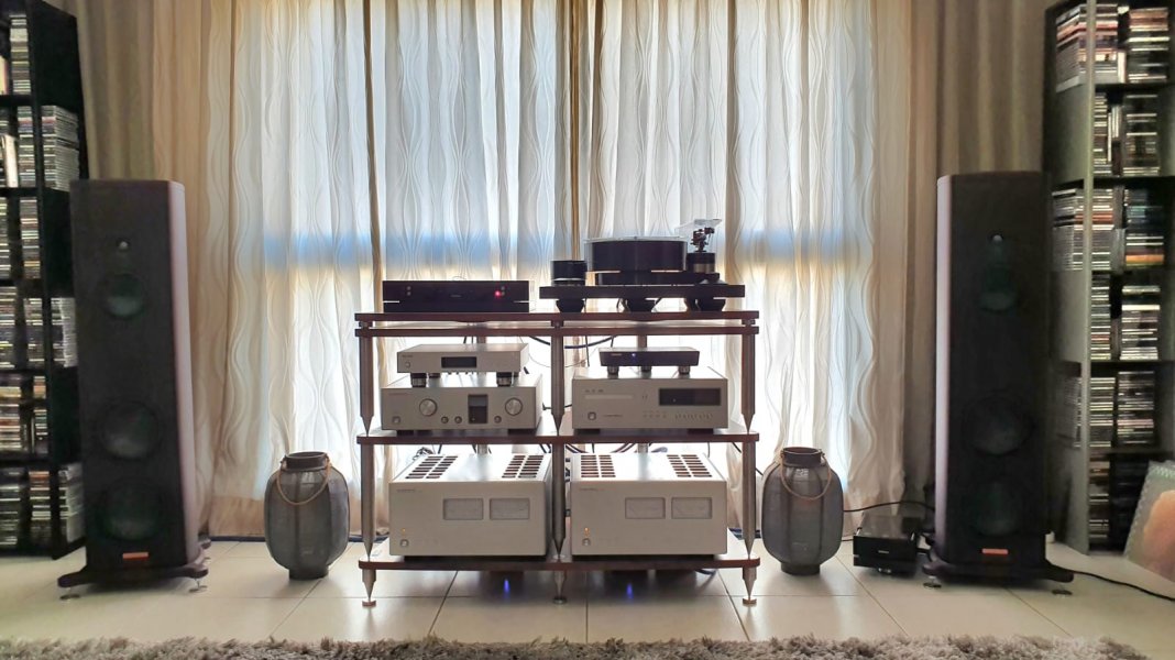

The feeling of overwhelming a small room with a big speaker is usually a result of this room's acoustic mods that are building up the bass in some places. The smaller the room, the bigger the problem is. A smaller speaker is easier to move around to find the perfect spot. There is nothing inherently bad about having a big speaker in a small room (except for it being a huge piece of furniture).
today i shifted my system 90 degrees from where it used to stand, now i do not have a wall behind my head and there is more space for the speakers, the sound had dramatically changed for good.
on my space, Magico S3mk2's are good but, S5mk2's would be better considering the space size.
