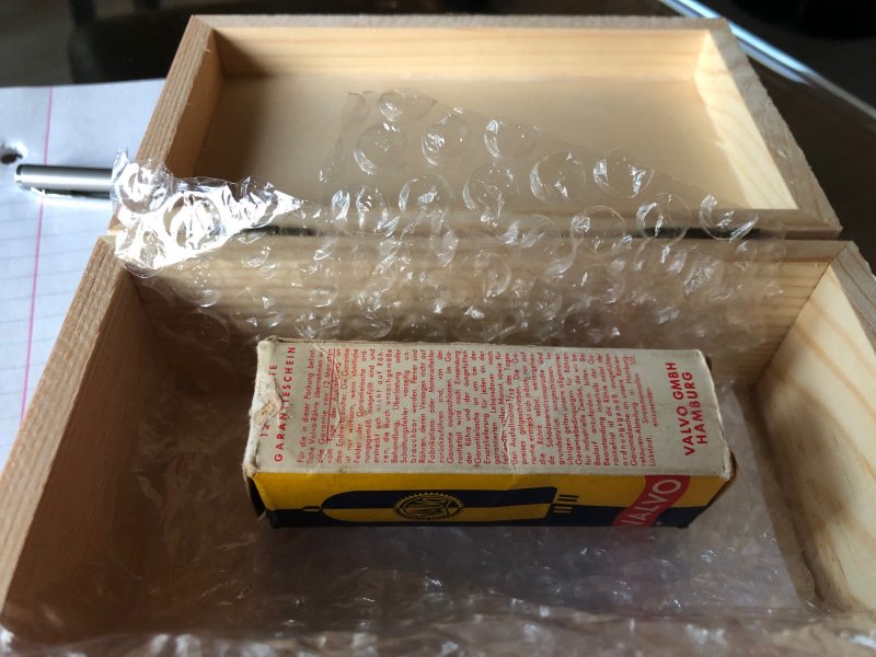

I'll share with you what my research of the E80CC uncovered. The Valvo Red Label, O-Getter from the VB8series or WK6, was indeed made by Philips, Herleen. It too was the "pinched" waist type.
The Valvo E80CC with the Flat Foil D Getter, Pinched Waist, with the WK2 D61 codes etched on the stem (circa 1956) were made in the Valvo Hamburg plant. I have tried the WK6 and WK2 versions and I prefer the later. A bit more transparent and holographic. Both are very articulate.

man, ill be damned. ive seen many valvo-labelled herleen coded E80CC, but ive yet to come across a valvo hamburg-made E80CC. pretty sure i never came across the ones made in new york. lots
and lots of deltas and much more tungsram. i been lookin like crazy thru any E80CC i come across.
i got a DAC that runs a pair lf E80CC and a phono amo that can use one in the output stage. i mailordered up a d-foil getter pinched waist for that. i dont have photos
ofmthe etchings, so…man i wonder. assumed it was dutch.
u comenacrlss anyone sellin valvo hamburg or tungsram nickel plate E80CC?

This is the only one I have come across recently. It's used, but tests strong. It's being sold on Ebay by auction.https://www.ebay.ca/itm/204434249217?hash=item2f993b1601:g:MB8AAOSwgNZk35TR&amdata=enc%3AAQAIAAAA4MIHzg3ZaInwIpDvNUrCNZx2BjLoaheOAT86FlRAJC6SeVqDc1YkMOtqvUmKkPs6GQ3VfmaV7rNb0uDjjeF30T8NmCzXo4ZinH47UaVv1nRQILiz08MVXlF9unP1siah8xyYv0L3CI14feUSAoHNyYpZZ2gwJcfyu4GF4TMZy2k8Zd92qE4IFGCsI%2BM1xAeAr0FpphvMEuytK15pZntMkQJ5%2BLV0NWkXwfThJOxshZE68d%2FR%2FlASNlz4fuceiZ%2B0ZcW0g5SZ47NgP32nmGR06iBJX5QQ5x3j0Po37LblKpG%2B%7Ctkp%3ABk9SR6j5153GYg

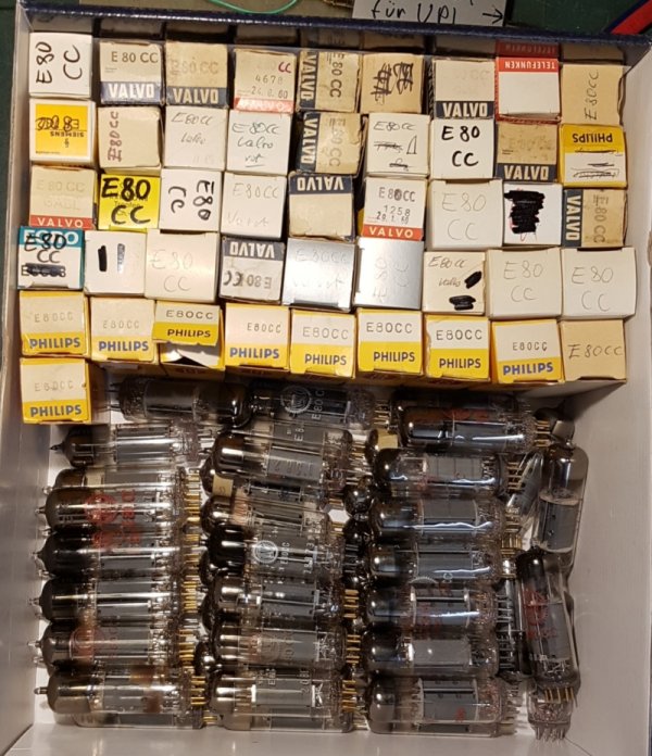

I have also a few E80CC :) .

Hi Alexander. That is quite the stash indeed. Do you have a NOS/NIB WK2 Valvo?
Regards,
Ray
Kind regards , Alexander . View attachment 115739
Any of them for sale?
