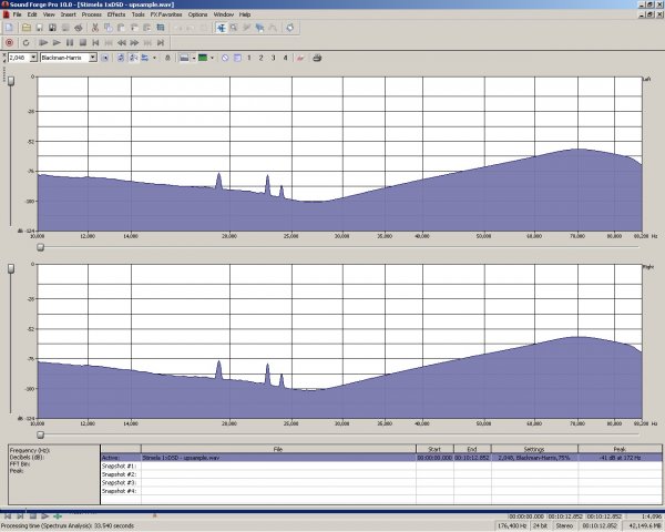

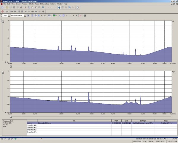

Peter has been a big proponent of DXD when it was first extablished as the editing mode for DSD. I will have to say he is incorrect when he starts talking about UHF frequency building up and starts exceeding Scarlet Book spec. This was true 10yr. ago. That's why we now record at 2x and 4x so we won't have that build-up and can do multi-track mixing or multiple conversions.

You really don't need graphs. The UHF noise in DSD64fs starts around 24k and rises from there.
DSD128fs pushes that noise out one octave where it starts at about 48k and so on for DSD256fs.

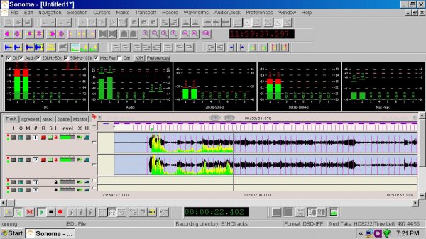

Now the Scarlet Book spec calls for only a certain amount of UHF noise can be had from 20k-50k and from 50k - 100k. You can see how we measure and make sure we don't go over the limit here on the Sonoma screenshot. Here the UHF is exceeding the threshold that is allowed for 50k - 100k.
