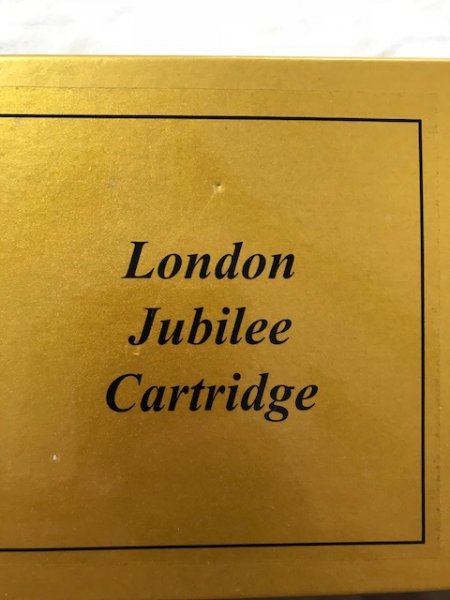

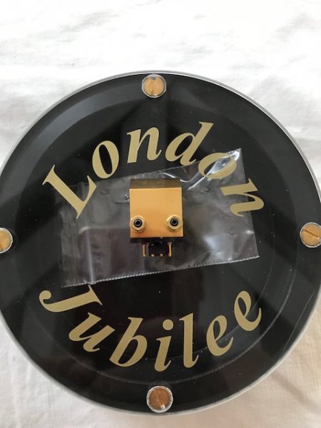

I am near to buy Decca Jubilee,i never listen a Decca,but know difficult to set up,but for some record is very special for dynamic and transparence
I would like to try with Torqueo and Saec 506 and with Schopper and Koetsu
Someone has or listen?

Jubilee should work fine in the Saec they like knife & Unipivot tonearms
owned several Londons for decades & use a Reference at present
Deccas are highly musical & do make most cartridges sound flat & lifeless

As you probably already know the Decca has very high lateral compliance and very low vertical compliance. The tremendous energy it generates can cause mistracing/mistracking or overload if the arm has insufficient damping. They also tend to be more picky about the cleanliness of your records, and sensitive to hum.
Decca's own arm was a damped unipivot, so I would agree with the choice of the SAEC, at least initially. The FR 64/66 could be a good future choice.
