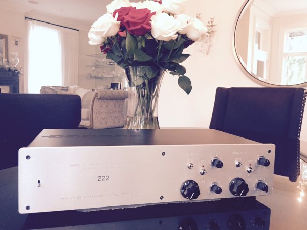

I have one.
I have never compared it to a Doshi although I've heard a Doshi under show conditions. I'm still evaluating mine even though I've had it for some time. Just not enough hours on it.

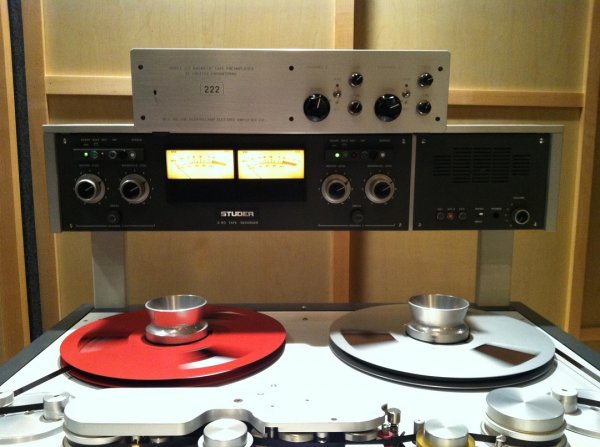

I had it for a few weeks with my Studer. It picked every radio station known!!

Never got it
Hi Bruce, I am considering purchasing a De Havilland for use with my A80RCmkII. Did you ever get the RF issues sorted out? If so, what did you think of it's performance?
Never got the issues with the 222 sorted out. I tried the King/Cello and felt it was too noisy as well.
Had Nick build me 2 of his units and never looked back.
