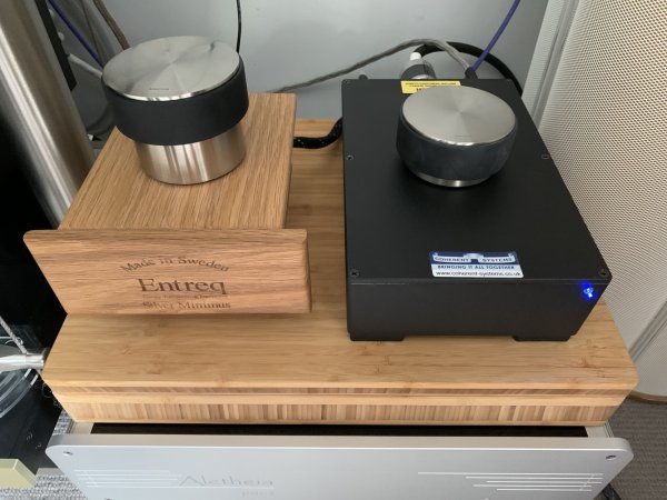

Hi Jay
IMHO, everything starts with your Mutec Ref 10 10MHz reference clock signal.
Run one 75 Ohm BNC Clock cable from the Ref 10 to the dCS Rossini Clock 10MHz reference clock BNC input. This will, in turn "re-clock" the dCS Rossini DAC.
There will be five other 75 Ohm outputs as well as two 50 Ohm outputs on the rear of the Mutec Ref 10.
It sounds as though you currently utilise three of these outputs (the EtherREGEN is usually 75 Ohm. Not sure about the SOTM products).
It is difficult to advise on a network connection path, without the aide of a diagram.
In my own case, I start with a Mutec Ref 10 SE-120, sending a 75 Ohm signal to the 10MHz reference BNC input of my dCS Vivaldi Master Word Clock (this in turn, synchronises the other dCS components in the stack (Transport, DAC and Upsampler). I use a second 75 Ohm output from the Mutec to "re-clock" my EtherREGEN switch, which is also powered from one 12v rail of an ultra-low noise LPSU (Coherent Systems QP-1). My own network is simpler in that, from a TP-Link AC2800 Modem/Router, the signal is carried by a 1m LAN cable to the 'A' side of the EtherREGEN and a second 1m LAN cable exits the 'B' side of the EtherREGEN and enters the ethernet input of the dCS Vivaldi Upsampler. I also use a Melco N1ZH server/digital library which is connected directly by USB cable to the dCS Upsampler. A second short LAN cable exits the 'A" side of the EtherREGEN to an ethernet input on the rear of the Melco to allow control of files and Qobuz Studio streaming via an Apple iPad and dCS Mosaic App. I do not "re-clock" the USB signal.
I hope that makes sense!
