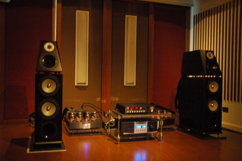

Boy 7 years went by quick. I found this pic of my old place online.
Very nice jack
