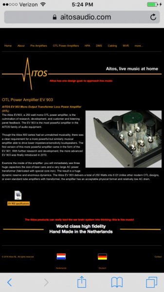

Aitos EV 903 250 watt OTL amplifier

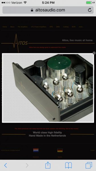

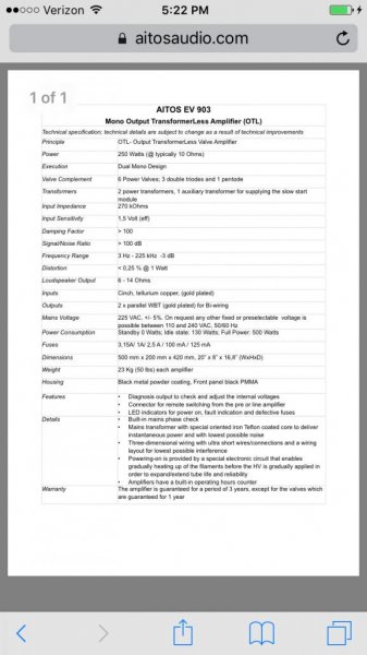

Never heard about it, but 6 x EL519 in an OTL configuration can not deliver 250W at 10 ohm. Even at 10 ohm 250W needs a lot of current.

Also notice that the rated distortion is 0.25% at just 1 watt, so you can only imagine how high it must be at full power (whatever that may actually be) since they choose not to even specify it.
Perhaps if it is running nearly all Class B?
morricab
Apr 25, 2014
9,531
5,068
1,228
Switzerland
No. They are probably referring to peak power in some strange conditions that does not apply to audio.
Look at the specifications of the fabulous Technics 20A, an OTL that used not 6, but 10 similar power tubes per channel. http://audio-database.com/TechnicsPanasonic/amp/eaa-2007-e.html.
It sounded great with ESL63.
Also, these are monos and hte Technics is stereo. so it is really 12 for a stereo amp...nonetheless, it seems unlikely to get that much power.
With the amount of feedback used they are probably pretty flat distortion-wise until clipping.
