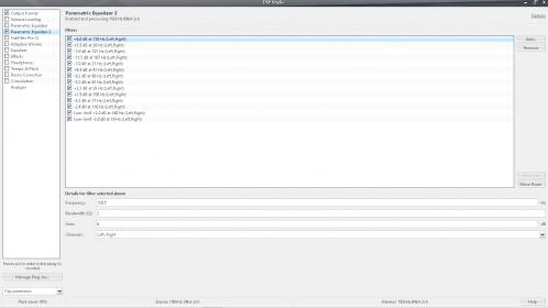

Nyal and I have been working with REW. I am stunned at how powerful REW is compared to what I knew before using XTZ room analyzer. Nyal generated some excellent filters using several measurements we took using REW Filter Adjust. I attached a screenshot of my jriver PEQ tab. I added a couple of small low shelf filters just for fun. :cool: All of these filters are below 200hz. I think they sound better than any other filters I've ever tried.
My understanding is that Jriver uses IIR filters and dithers them to 64 bits. I have no problem with the sound. I think it sounds great and I can't hear any degradation using these filters. However, I am interested to know what the same filters would sound like using FIR. I want to preserve phase as much as possible. Is there a way to manually create FIR filters and use them with Jriver convolver?
