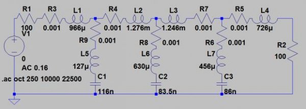

    OK let's kick off with a fairly simple schematic for a filter. I've already posted this one on the older thread but didn't talk much about it and nobody commented on it at all. Its what's called an 'elliptic' filter - this form of filter has the steepest transition band of any known filter design. A transition band is the area in the jargon between the passband (the signal frequencies you want to keep) and the stopband (the stuff you don't want). Its designed to go on the output of a NOS DAC and starts cutting off around 17kHz. By 22kHz the attenuation is around -50dB. The filter I am hoping is going to improve the rather uneven HF of my NOS DAC (to be presented later) by chopping out the ultrasonic image frequencies that are inherent in NOS designs. As of writing, I've only built one channel and not listened to it so far. I'll post photos some time after both channels are completed.
    Slow and stealthy slug gets the lettuce. DIY audio blog : http://www.diyaudio.com/forums/blogs/abraxalito/

    Quote Originally Posted by opus111 View Post
    This thread for me is likely equivalent to the college student taking Algebra 1...and sitting in on Calculus. But what the hell...;0
    So this is an analogue filter if i am not mistaken...which some designs use in their NOS dacs, yes? And it has to do with rolling off ultrasonic frequencies as you say, i think i got that part. The question i have is...if humans are 'technically' able to hear 20khz and some argue beyond, then why the rollof at 17khz? (which i think is probably my threshhold for all practical purposes anyway based on some half-baked listening/tone tests) Why not start the cutoff at 25khz? Just curious to learn.

    Wow, nice to see you over here Lloyd With your questioning we should be able to make this more generally accessible to others who would like to savour the 'school-room' environment!
    Excellent question to begin with - its 17kHz for a few reasons. Firstly because I can't hear up to anywhere near 20kHz any more. Secondly to make the filter practically possible. Its a requirement to cut off everything above 22kHz and if the transition band were just 2kHz (rather than 5kHz as we have here) the filter would be more than twice as complex. Its already a bit of a struggle winding 7 coils, per channel
    Actually I'm not aware of any commercial DACs using such a filter. Your Zanden's filter is rather a different design because he didn't want the phase shift which goes together with this kind of filter. Me, I'm not so worried about phase - not until I've heard it that is. Have to build it to see for myself.
    We don't start the cutoff at 25kHz because that's too late - the NOS DAC's image frequencies begin at 22.05kHz, half the sample rate.
