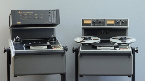

For the comparison of the two recorder-reproducers shown (Ampex ATR-102 and Studer A820), we put in identical half-inch repro heads and cables and connected them to identical playback circuitry.

I would expect they would sound different... Different transports will have different vibrations, wow and flutter, variations in tape path, etc. that will cause changes in the sound. I suppose it's possible the differences on a couple of excellent transports might be inaudible but they'd certainly be measurable.

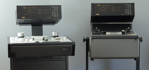

A meaningful evaluation of different tape playback electronics requires first that the electronics are each carefully aligned to the calibration tones found on the master tape used for the playback comparison.
A comprehensive set of alignment tones recorded to the master tape is a hallmark of any professionally made analog recording. Correspondingly, any true tape recording professional would regard playback electronics that will not accurately align to the standard equalization curves as merely sadly misguided consumer toys. (Imagine the chaos of comparing phono stages that do not accurately follow the RIAA curve.)
Some people assume that the differences between different tape playback electronics will be much more readily audible than would be any differences between different transports. However the reverse is true.

Now, a few words about the pictures of Ampexes I have posted and some personal disclosure. Visitors to my company Audio Transfer Laboratory, sometimes express surprise that we have Ampex ATR-102s on prominent display. Especially when they know that the parent company (Adolph Thal Audio Engineering) is founded largely on borrowed Studer tape machine design engineering.
The answer is that the Ampex ATR-102 was hands-down the most popular tape machine employed by the US-based record labels in the late 1970s through the 1980s. So, keeping our two ATR's in top operating condition gives us some immediate street cred with many surviving recording engineers from back in the day. Further, it affords us a very familiar starting point for demonstrating to those people what we believe is the clear superiority of our modern, Studer transport based ATAE reproducers.

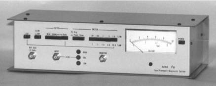

(...) Manquen developed an instrument that allows one to both see on a meter and hear over a loudspeaker or headphones, the grunge (the unwanted AM and FM distortion) that is added to the audio signal by a tape transport. Those of us who have worked on tape transport design owe a great debt of gratitude to Dale Manquen.
The Fred Thal posts have great information about this interesting subject. We can find the referred work and instrument developed by Dale Manquen in this site: http://www.manquen.net/audio/index.php?page=1 (Full site : http://www.manquen.net/manquendotnet/audio/)
The Altair Tape and Transport Diagnostic System is shown in the picture. According to the site "The system provides independent AM and FM measurements in the passbands of .5 Hz-250 Hz (mechanical components only), 250 Hz-5 kHz (scrape components only), and .5 Hz-5 kHz (all components combined). A weighting filter is included for conventional NAB and IEC weighted flutter measurements. Residual measurement noise for the widest bandwidth is typically .005%RMS for FM and .1% for AM, which is approximately 20 dB below the best transport and tape tested to date."
It is a fantastic all analog instrument. There is information enough in the paper to develop a virtual instrument using a high quality soundcard - it should be a great Labview project for students!
Thanks for posting.
