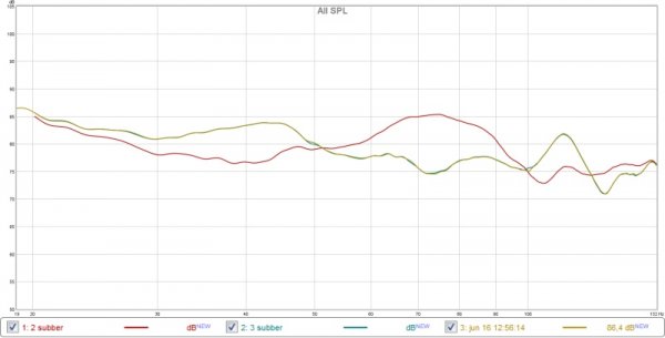

Don't know if this has any interest for anybody but here is a meassurement of what the third sub does. After careful placement.
No Smoothing or any EQ.
