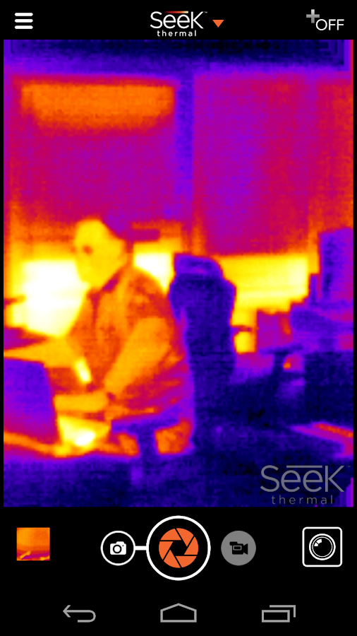

A start-up called Seek Thermal hopes to change that equation, rumored to be able to bring the retail price down to $200 to $250. They just released some neat images to show the capabilities of thermal imaging:
As you can see, the technology is remarkable. If someone integrates one into a tablet it will be killer.
Once a broad consumer market is created, I suspect the prices will keep going down. There are low cost sensors but resolution is poor. The Seek Termal is 32,000 pixels total which is what you need to resolve smaller detail. And it is much smaller, plugging into the bottom of the smartphone.

FYI I have one of these now and it works! It is not perfect. But for $200 in a very tiny package it is remarkable. Alas, it plugs into the USB jack of my HTC phone. That jack for whatever reason is backwards. So the infrared camera points at me rather than the other way around! Have to upgrade my phone to be able to use it.
