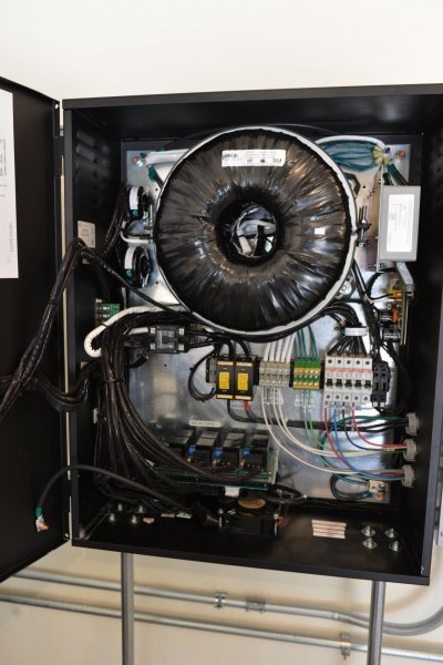

Thanks for all the responses. Conceptually the isolation transformer makes sense, but I've heard so many negative stories about them. It would be tough to take that leap without hearing some examples of positive experiences. I have read some of your posts in the past regarding the Double Conversion UPS. It sounds interesting.
I had a 90A Torus Power panel installed a couple of months ago and it was an excellent move. System has never sounded better. Also use Shunyata conditioning and they work very well together.

Frank750, I followed your thread about the Torus. Ultimately, did it "change" the quality of the sound? I'm sure we have all had experiences where we add something and there is a clear effect. Often it's tough to say it's better, just different. A challenging question I know.
In my case, the Torus was an absolute necessity and an audio life saver. I had spent almost a year chasing a problem destroying the sound in my room. I had industry experts, electrical trouble shooters and anyone I could think of into my house to try and solve my issues. After swapping out every piece of equipment, wire, outlets and anything else associated with my audio room and system, I discovered that a small isolation transformer in an old Richard Gray conditioner appeared to make a positive change in system performance. I then tried a little larger Torus rack unit which made an even better impression and gave me the impetus to purchase the Torus wall unit.
Without the Torus panel, my system is unlistenable in my room. With it, the sound is glorious. This is not exaggeration, it's fact. No one could ever tell me what happened. I live in an area with many restaurants, bars and stores. Something changed with my electricity during the last year, (I've lived here 8 years previously with no problem) but none of the people I brought in to diagnose my problem could find the cause of my issues.
Thankfully, the addition of the Torus unit has allowed me to enjoy listening again and stop the incessant analyzing of my system. I was not looking for an "effect" with the installation of the Torus, I was seeking a solution that would allow me to listen to a high end system in my house again and the Torus panel delivered.

My Torus unit also has optional surge suppression.
From Torus:
A Transient Voltage Surge Suppression (TVSS) device is provided with Torus Power All-in-One Panels (AIO), and is available as an option for Wall Mount (WM) and Floor Mount (FM) models. These UL certified Panel TVSS devices have a sub-nanosecond response time and manage surges up to 120,000 Amps, model depending. The TVSS also offer additional
noise filtration of EMI and RFI (40 db typical).
