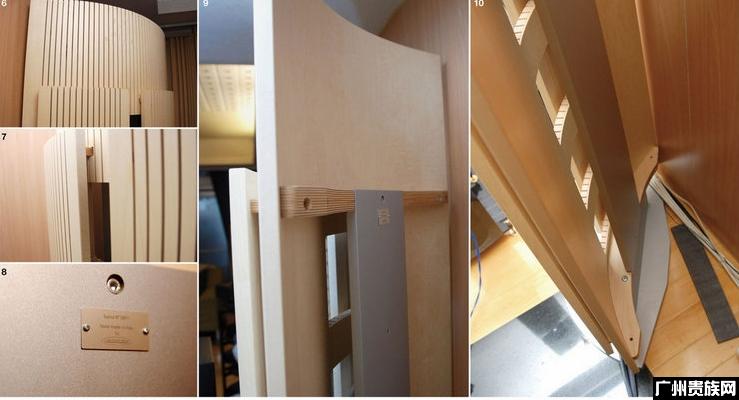

Could the gray vertical slab in the middle be a thick piece of metal?

All I see is a modified "poly" (poly-cylindrical) diffuser with some non-functional slots cut in it to create visual interest. The slots aren't sized or arranged properly to add any other sort of diffusion to the mix. For example had the manufacturer spaced the slots properly and added 2-4" of absorptive panel behind, you would have had a 1D binary diffuser/absorber combined with a poly. I could have respected that. This thing is more artsy sculpture than useful acoustic treatment.

It is an open back, so it's not a A Helmholtz resonator or Helmholtz oscillator.
However, the slots and strips of wood are square in section, so it is a ban pass filter of some kind, and also like peg board that induces a time delay with additional diffraction on the back side.
1. Curved shape diffuses and reflects in convex/radial pattern.
2. Panels absorb a little energy through mass of wood.
3. Panels vibrate and re-radiate to surrounding air at different frequency than original.
4. Mostly it's the slots ricocheting energy via depth, and the smaller panel in front seems to line up with the larger panel behind making the depth of the slot longer when perpendicular.
I'd feel better about possible absorption if I saw some acoustic wool/felt or a sheet of MLV behind it, so as it stands it's a diffuser only - and a pretty one.
I did find some interesting stuff while trying to find the right words to use and or find examples.
Difforber
Abfuser (Bastoni Panel)
As far as the slots doing "nothing" I have to disagree, they do something just not maybe that great of thing, everything does something.
Think of it similar to a slotted wood ceiling or grille, but without the acoustic filler that broadens the frequency range.
Examples:
Armstrong - wood ceilings and grilles
https://www.armstrongceilings.com/commercial/en-us/commercial-ceilings-walls/wood-ceilings.html#bbbh={"selectedItem":{"name":"browse","itemIndex":null}}
Sound Absorption (NRC) Up to 0.90
The example above based on the installation PDF is just wood planks and slots, no acoustic felt.
Click on DATA PAGE and download the top PDF for acoustic information in link below.
https://www.armstrongceilings.com/c...ngs-walls/woodworks-grille-ceiling-tiles.html
I don't know what the Yter panels originally posted cost, but one may wish to consider an entire slotted wood ceiling or wall as a competitor if cost are similar.
