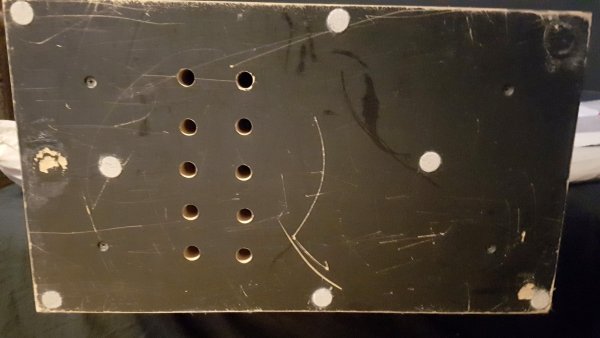

I am new member. Hello for everyone. I would be very gratefull for help with Genesis 501.
I want to buy Genesis 501 loudspeakers ( used, upgraded in very good condition ) but I have a question:
at the the under bottom stand every loudspeaker there are holes ( 10 holes ) is it normal? Please look at the picture.
Kind Regards for everyone.
I have never seen anything like that before. Do the holes go through to the woofer chamber? How were these speakers upgraded? If you would like to have a chat about these, you can give us a call in the office - 9am to 5pm Pacific time.
