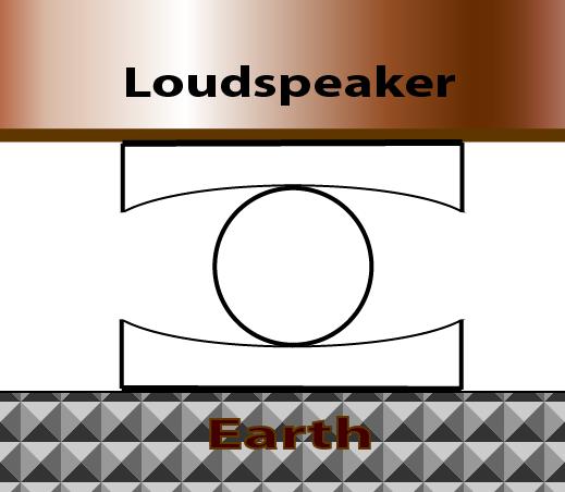

This may come as a surprise, but the highly popular captive ball in two cups device is actually viscoelastic.
In the vertical plane, the ball and cup is a very effective coupler. The small contact patches providing an almost spike-like contact area.
In the horizontal plane, however, it is moves almost freely. However, because of the action of gravity, the ball will always return to the lowest point on the bottom cup, and the top cup will always center on the ball. The gravity is the “spring” that centers the device – and hence confers elastic properties depending on the diameter of the ball, and the profile of the cups.
Considering the forces in the horizontal plane, as the ball rolls, there is friction between the ball and the cup. This results in a loss of energy, a generation of heat, and a viscous property. Depending on the material of the ball, and the material of the cup, you will have different coefficients of friction. The hardness also matters as elastic deformation can occur on the both the ball and cup. Hence, different balls will make these devices sound different. With sufficient hardness and low enough friction (think ruby ball on a ceramic cup) they can also be elastic in the horizontal plane.
Hence, the ball and cup and related ball and race devices are a special class of viscoelastic coupler/decoupler, with almost perfect coupling in the vertical plane, and viscoelastic properties in the horizontal plane.
