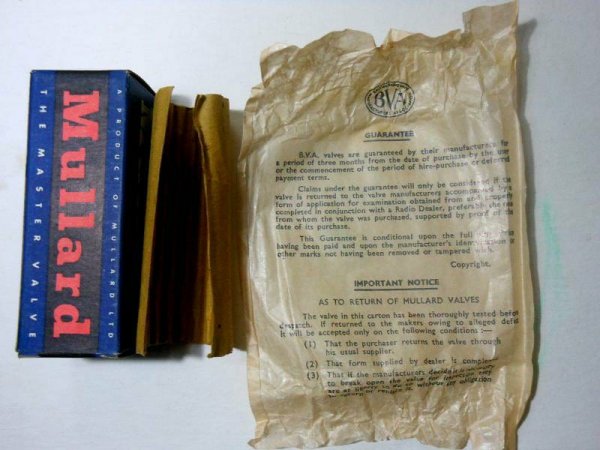

My small stash of Mullard 50s Long Plate (round and square getters)
Matched pair NOS 12AU7s with original box and a July,1956 sticker price of $2.20.:cool:
Original Box with 'crumpled' guarantee paper/certificate
Mullard LP Sq Getter MC1 B7C datecode (Blackburn, March 1957)
