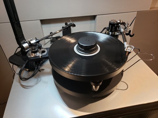

Dear All,
I am trying to install a VDH colibri XGW on my Triplanar (my existing cart if a Lyra Kleos which is fine). Now when I adjust the overhang, I see that the VDH needs to be set far back in the head shell because the cantilever extends forwards a lot. Anyway - it requires it to be so far back that the back of the cart actually sits on the lip of the arm not flush against the head shell causing this strange angle as below. Furthermore the left part of the cart touches the left part of the arm so I can't alter the orientation of the cart:
Does anyone have experience of Triplanar with VDH colibri and is there a solution? Or am I doing something wrong?

Hi Bill
You have effectively made the tonesrm longer and therefore its arc has changed if the Stylus is beyond tonearm
If you wish to use this cartridge
You can add spacers over the cartridge
Or push the tonarm back on it current mounting position see below...
Please note as per Michael Fremer that the jig is incorrect on original triplanar and you need to go on the measurements as per spec sheet
It's about by about 4 to 5 mm
This might also be your problem?

Hi Guys,
Thanks so much. I am using the Feickert protractor and actually checked the spindle to pivot distance as per Triplanar site which is 233.5mmm - this seems exactly as per my tt and arm set up, which is a Kuzma pre-drilled arm board. Remember it is fine with my Kleos...
I was also thinking the solution would be spacers - do you guys have any recommendations and will they be deleterious? I am effectively changing the headshell weight I guess?

Hi,
This Colibri is a good deal longer than my Lyra - much longer in fact. It isn't the body so much but the protruding nature of the cantilever really adds to it.

I can't use spacers either actually because the rear of the cart hits arm tube and would need like 0.75cm spacer:
As you can see I can't adjust the orientation according to the parallel lines at the null points because I can't rotate it...

You can change the effective length two ways
One is to use smaller bodied mounting screws which will give you about 4 mm of wiggle room
The other is to take the triplanar off
And underneath is a mounting screw that holds the base to the pillar for vta
This is very tight, but loosening it allows you to push back the pivot point to accommodate this cartridge
I think this might void the warranty so you need to check with Mai
This will then allow you to mount the cartridge
Good luck

Thanks so much Awsmone. I think that the solution of removing the arm and loosening it to bring back the pivot point might work.

Coming back to this thread. Bill did you ever resolve the issue with your Triplanar and the VDH colibri XGW?
Hi Tima,
Only insofar as I ended up altering the effective length and geometry with the tweak as per above but it resulted in not a good sound - too much sibilance for me.

Hi Tima,
Thanks for the follow-up. I had a similar situration and similar results. My solution was to use the vdH with a different toneam (4Point). The cart was still fairly far back on the headshell. I hear what I can best describe as the possibility of sibalance, but nothing overt, yet. Still have quite a bit of break-in.
I spent ages trying to make it work. I must have spent a 2 weeks altering ever parameter to improve things (Triplanar very good for this) to no avail.
