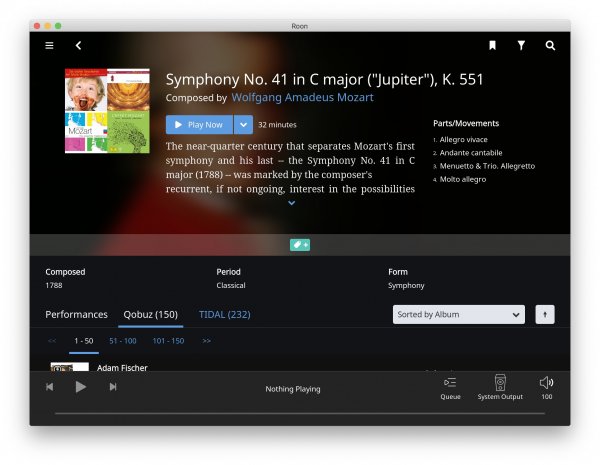

#19
Ron,
Here's just a sampling of what's available, one of your favorite pieces... 150 performances in Qobuz, 232 in Tidal!
