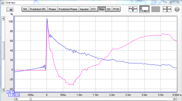

One of the big attractions for me is the exquisitely smooth polar response and almost ESL-like time domain measurements.
Here's my ESL hybrid step response at the listening position (if that's a valid comparison). Red, uncorrected, Blue, with AcourateDRC. I can't do a polar response, but I'm used to their directivity. I don't have to worry about the walls and ceiling, all I see is the bounce in the long dimension of the room (and the initial dipole bounce) when looking at measurements.
I think one of your Acourate comments in another thread made me buy it, a couple of weeks ago. Thank you.
Very nice step response. I love acourate too. I had a little mishap recently with a measurement so I'm out of commission for a little bit, again. :D I may get these little babies just for some fun and later turn them into rear surround channels in a four channel surround/mix-down setup.
I've posted many measurements on this forum. Unfortunately, I've run out of channels to loop back through Jriver ASIO line-in. I have a 6CH setup with four subs and R/L speakers. My Hilo only has 8CH in the mixer the way it's currently configured. That's not enough for me to loopback. I need channel 7/8 to direct REW output through my Hilo and copy to an unused ASIO reccord channel so I can use that channel as my Jriver ASIO line-in channel. For some reason, Jriver will crash unless the ASIO line-in channel is not the same number as one of the output channels in use. I need to crack open the monstrous Hilo manual and figure out how to set the Hilo up into 16CH mode. I think I can loopback in that mode and get some new measurements up. My predicted measurements are scary flat with four subs. I have no doubt that REW loopback measurements will correlate well, since they always do.
I know there's some controversy about poor lateral off axis with ESLs. However, I bet that can work to your advantage in certain situations.
