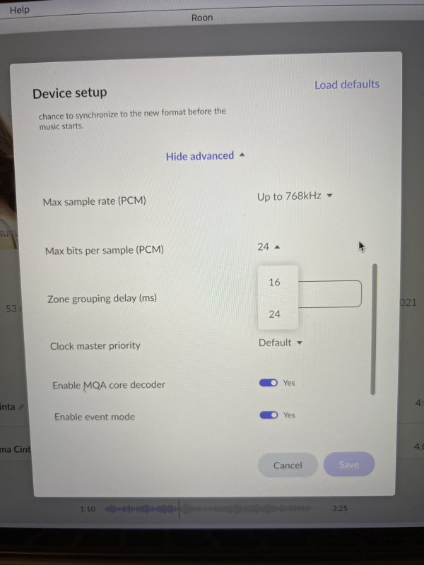

I don’t understand why my DSD files are all converted to standard PCM 24 bit when playing? DAC is Pillium Elektra and Taiko Extreme got the USB driver/compatibility right automatically from the get go, I didn’t have to access the Taiko Extreme Windows OS from VNC to manually install driver for Pillium Elektra, and I couldn’t find any file on the internet for Pillium Elektra driver anyway.
Pointers please, this got me quite frustrated.
Your windows don't show all the settings. Is it possible that you have selected DSD over PCM (DoP)?
I use "Native" and this allows DSD streams to play natively to the CH C1 DAC, even over AES/EBU.

You were absolutely correct, I ticked DSD over PCM during initial setting. But there is no Native option my mine. See below

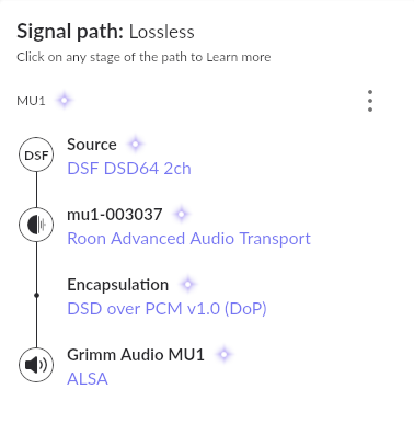

Actually, the lack of the "Native" option will probably not be the culprit. My path is still, "purple" (Lossless) even when selecting DoP. See below.
Can you confirm that no DSP / SRC is enabled in Roon?

Fixed!! Factory reset does fix a lot of things. I get everything except MQA now since Pillium doesn’t support MQA
Also make sure you select the "Taiko Audio USB Device" with subscript "ASIO" as your output device. Disable all the other outputs ("System output" and whichever has subscript "Wasapi").
You can also have Roon perform the first unfold of MQA if so desired, for the second unfold you do need a DAC with MQA decoding.
