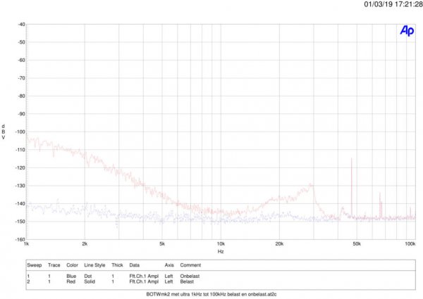

Sbooster BOTW Gen2

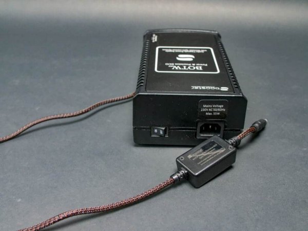

Sbooster is well-known in the world of nutrition. The new linear BOTW gen-2 must be a bit better than the previous versions. We have the 12-volt version with a built-in "ultra". Another Ultra can handle that (that box ... so there is a voltage regulator chip with filter in it ...). We have tested with and without an extra box. However, we did not know during the test that the power supply should be at 13-volt if you connect an extra Ultra ... then the rising noise disappears after 30 kHz.
Sbooster also supplies its linear power supplies with all kinds of adapter tips. Everyone must be able to find the right size. The extra Ultra is optional.
MEASUREMENTS

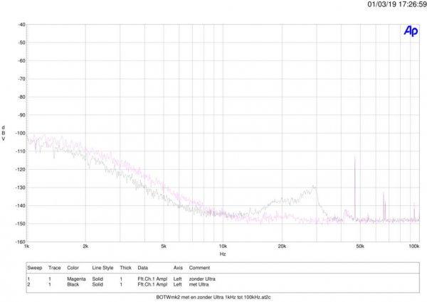

The Sbooster performs well. Remarkably stable compared to some competitors. We only see 50 Hz harmonics in the 50 - 700 Hz range. Then it disappeared. A bit silly: with the Ultra connected, the harmonic shifts ... We can't explain that; a phase shift?

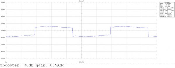

The Sbooster can follow a square wave. We see a good response to our injected signal. Neat flanks; no wrinkle. Without a doubt a neat performance that shows that the food is pretty stable and fast.
Voltage loaded: 11.7
Voltage unloaded: 11.74
Noise max: -83 (100 Hz)
Noise min: -148
LISTENING

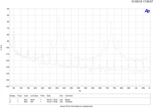

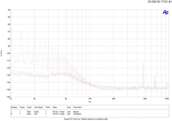

MEASUREMENTS
Keces P3

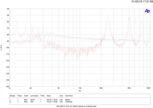

We see some crazy things on the AudioPrecision. The Keces P3 - and P8 - swing without load. (Much less than the standard wall plug, but more than the competitors). These oscillations are gone when the feed is loaded. And then the P3 is also very quiet. In the high frequency, the P3 is less quiet than the Sbooster and certainly less than the Farad. But the values are still neat.
In the second test with the square wave, the response is neat. No crazy distortions, fraying or other carelessness. It is striking that the block is a bit rounder than the competitors. Whether that is audible is another question ... It is measurable and reproducible.
Voltage loaded: 11.75
Voltage unloaded: 12.01
Noise max: -55 (370 Hz)
Noise min: -150
Reactions: vhs

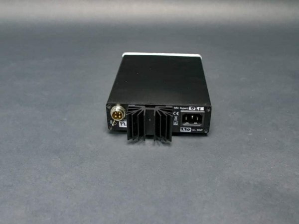

FARAD SUPER3
Farad is a new brand that comes from the Pink Faun stable. We have a first version with a housing that can still change. Technically, however, it will remain the same. That means that we can take this into account in the test.
The Farad has one output with a voltage of 12 volts in this case. You can choose between standard cables or a chic cable with a nice boot and a kind of carbon plug. (additional charge 60 euros).
The design of the Farad is a bit different. This is mainly due to the super caps (hence the name Super3) that Farad uses. That also means that this power supply needs to charge for a while before we can switch it on and start using it. Count on about 30 seconds before energy is transmitted. The same applies the other way around: draining the Farad takes a while ... It really is a kind of super-battery.

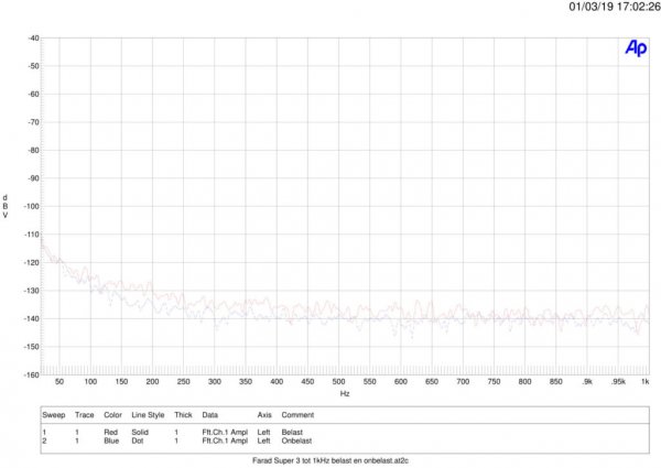

MEASUREMENTS
Farad Super3
Voltage loaded: 11.8
Voltage unloaded: 12.14
Noise max: -122 (55 KHz)
Noise min: -145
Sjonge… (WOW!) how good the Farad Super3 measures! There is actually no noise at all. So this is going to be a very boring story. We see nothing at all on the AudioPrecision: a stable noise level of around -140 dBV to around 1 kHz. From 1 kHz we see that it rises slightly towards the 50 kHz. But yes: around -130 to -125 dBV, so what are we talking about?
The square wave also comes through nicely, although it seems to be slightly muted. Perhaps the result of a coil or the supercaps ...
