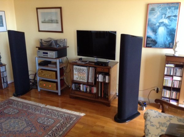

The consensus here is that the shape of the room accounts for the imbalance between speakers, so I include a photo of the system. Note how the left speaker - the lower volume - is near a corner while the right - louder - is free standing. Thus the right speaker dominates with the balance control centered. system.JPG

The consensus here is that the shape of the room accounts for the imbalance between speakers, so I include a photo of the system. Note how the left speaker - the lower volume - is near a corner while the right - louder - is free standing. Thus the right speaker dominates with the balance control centered. View attachment 42367
Well, let us stay with consensus. However I feel unhappy that something that can easily properly diagnosed with a sound meter (even a mobile phone app will do) and pink noise is solved by net democratic vote looking at photos of the room. :confused:
I feel that when we pay small fortunes for equipment we should not have doubts on its proper operation.
BTW, did you try swapping the left and right speaker?

Francisco, Jack is not a rocket scientist, and without seeing any pictures he instantly focused on the obvious. Nothing could be more simple. There are no two ways about it.
Bob,
Golden rule of stereo audio - there are always many ways about it. :)
