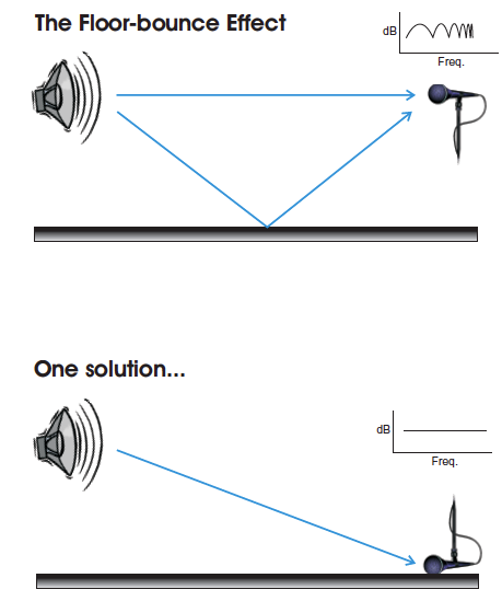

I have not done this type of work but one method used is to put the mic on the ground to eliminate the floor reflection:

Inside the room you will always have the room resonances, even if you measure very close to the cone. You will always have a floor bounce too, that even changes woofer loading. With the (pressure zone) mic on the floor you need to consider vertical room resonances too.
If your measurement software allows time windowing, you may not need to go outside.
Why not dig a hole and have the cabinet/woofer flush-mounted with the ground (firing to the sky)? You can place the mic over ist and there is no Allison dip (1/4 wavelength distance cancellation). Most of the measurements are free from side effects then.

Amir, I'm no expert, but putting the mic on the floor places it at a boundary, not usually the most accurate place to measure...
