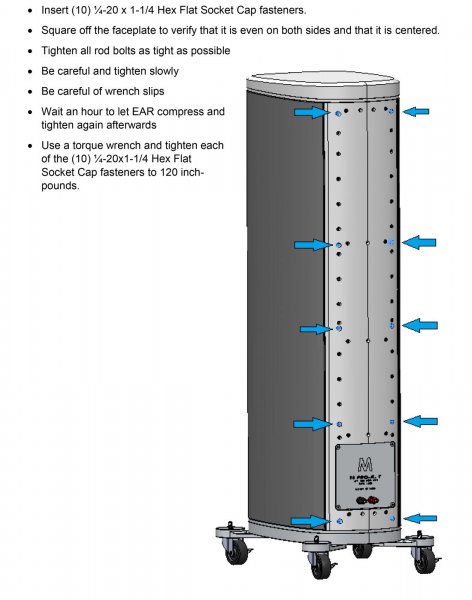

Instruction sheet for Project M :

This looks very familiar. Be careful not to strip any of the screws...
