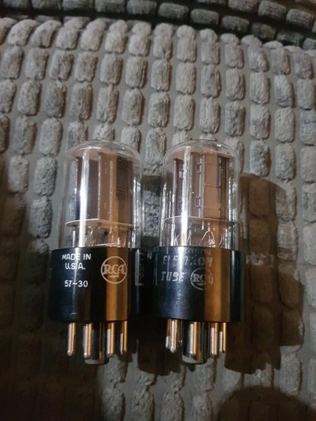

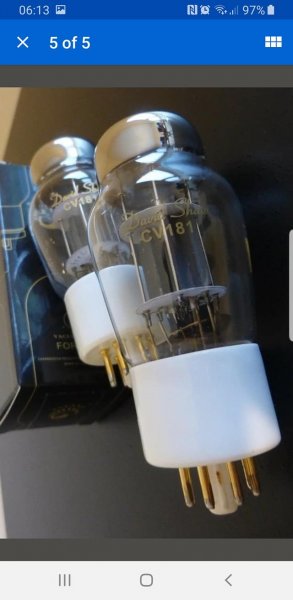

I would second DaveC’s recommendation of the Soviet Melz 1578 valves. They are quite neutral and musical with top of the tree performance. Preferred them to sylvania round plates. The cv181 valves shown look similar to the Shuguang Black Treasure cv181 which are actually 6sn7 electrical spec. Also very good. The rca in the centre should also be quite decent and I have extensively used the earlier smoked glass vt231 military ones. They will have a darker presentation than the Melz.

Thanks for all your Comments, I Should of explained my situation, I’ve been into solid-state Amps for about 18 years now and now for The last Eight months I just started with my first valve amp which I love very much, So at the moment I’m trying to study and learn about Valves Which is very hard to get in to And understand.
I’ve used and tried lots of new Valves Just to see if they make sound difference which they do, My problem is in my country UK there’s not a lot of choices for the 6SN7, This is why I am here asking questions about the valves with all your knowledge and experience with this type of Equipment, I’ve Gone and got them valves the CV181 and the RCA ones, Got them at a good price so I couldn’t refuse, so tonight I will be giving them a go, the Question was I didn’t no Which one should I go for, the CV181 or the RCA ones but I both lol,
