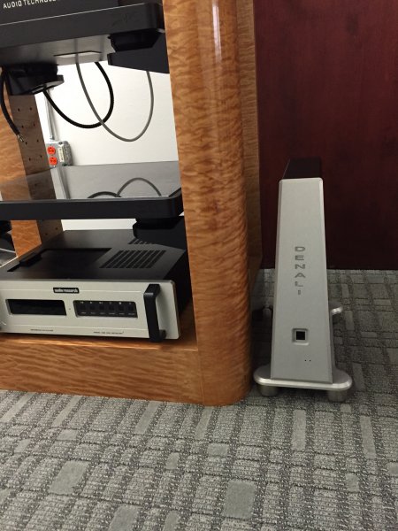

Here is a typical placement, however these vertical units can go anywhere and because of the form and customized base, they have no need for racks or external bases.
Regards,
Grant
Shunyata Research
