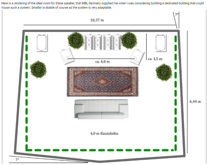

This is an example of a post in another thread that I think is helpful in this thread.
Reactions: HughP3

Since I am an MBL user and I am going down the path of MBL Extremes I am considering the SMT products. I just saw this link and thread. Will be in touch with Jeremy at MBL because it seems like the SMT products work well with MBLs Omni pattern.
