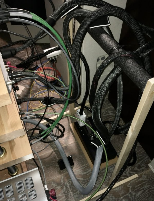

...it's weird, isn't it? It blows my mind to see great components and a rat-nest in back. I think it is also best practice to support cables such that they are not pulling on fixtures.
I have a couple of those "plastic" sleeves on the male IEC plugs to make a secure connection fixture-to-fixture. They cost maybe 25 cents each. The result is a firm, secure connection.
I also built a small hanging "rack" to drape my power cables in a path that both separates them and reduces stress. Without having oodles of open space behind gear, I don't know how else to stay sorted back there.
This is an older pic; I actually have it better sorted at the moment, but am away and cannot get a better pic. Most of them are now hanging from that rack, rather than draped over.

A few simple things to consider and do are :
Any power conducting wires should not be laying in close proximity to each other side to side or top to bottom and if one has to cross make the crossing at 90 angles to have the least effect .
Each power cable radiates emi
To have them next to each other may effect both cables
Next any signal cables should not cross over above or under any power supplies , nor power cables
I feel cable lifters keep the cables away from what maybe in the floor ie duct work , power feeders
Even metalized insulation . Radient floor heat may have metal channels to reflect the heat
Walls may also have all of the above inside as well. I laughed not at the thought but at how far we go to hopefully improve our systems.
Behind any rack is perhaps not as important do to short distances.
But i agree its still needed .
Cable management is real and needed , now how we accomplish this can be debated .

I started a new thread on Show Us Your Cable Management System. I am curios what people are doing, such as Marcus. Seems a better place to discuss the topic. Whether wood and wallboard impact a power of signal cable is a whole other thought.
As Al said, there is more in a floor and wall than you might think.
And how close wires are in proximity to each other. I think Al has a good point that power cables can cross at 90*. But a signal cable should always maintain at least 3 to 4 inches from a power cable in any direction. I would say is is especially important with a SUT.
