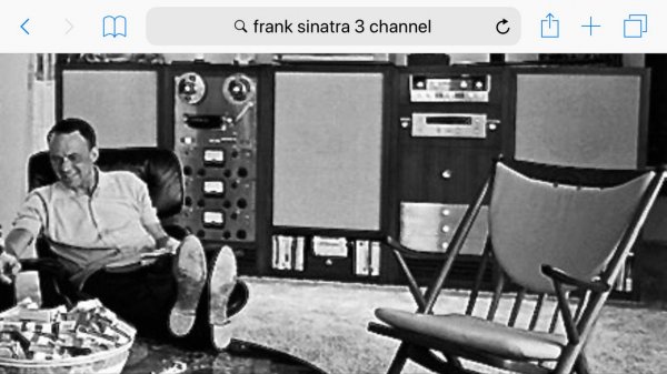

This guy had the right set up...
I believe if you have a 3 ch deck and tape, the best way would be to mix it down to stereo and then play that tape on a 2 channel deck through a stereo system. You would need a mixer like a Ampex MX10.

The system in that photo is a only prop. There were no commercially available open reel decks equipped with 1/4" three track heads. Three track 1/2 " configurations were used early on by RCA and Columbia initially on Ampex 300's, to record both the center track for the mono release, and provide some safety with the early stereo releases. The stereo "fill" of the session tapes could be adjusted with a rudimentary mixer to the center channel for the two-track release, to ensure proper stereo balance, as determined by the conductor and/or producer for the label.
Not a prop. The Presto 825 3 channel deck was used at Sinatra’s Palm Springs home.
http://forums.stevehoffman.tv/threads/sinatras-home-hi-fi-presto-reel-to-reel-etc.28325/
Well, sure that deck existed. More specifically, the photo shows a plastic 7" take-up reel on the machine. AFAIK, plastic 1/2" reels were never produced, so the tape in the photo would have been 1/4". The deck may have been fitted to play both 1/4" and 1/2" tapes. Playing the three tracks on the pictured stereo C-22 preamp, would have been another matter.
The McIntosh C22 had 3 outputs L R and L&R. However Sinatra configured the system,he certainly had the passion and money to get anything he wanted.
