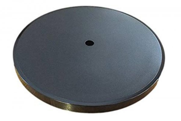

And below another product.
https://www.av-connection.com/?PGr=13611
Replacement platter for the Rega P1 og RP-1 turntable. Phenolic resin material.
Rega also uses Phenolic resin to outer coat their MDF plinths.
I'm seeing this product used in moderation in loudspeakers, turntables, platforms and shelves, could it be cost or too much of a good thing is overkill?
