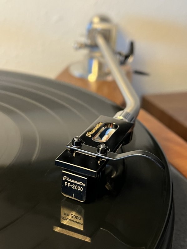

new Phasemation PP-2000 with Phase Tech CS-1 head shell. only a few sides but seems what I was looking for - relaxed, sophisticated almost sensual.

Hey PP-2000 users.
What are you guys tracking at?
And VTA?
This cart seems to be more sensitive to vta and tracking weight compared to my Lyras
Cheers

Was a while ago now, my dealer recommended 1.8g to start then I tuned by ear, I went very slightly heavier, can't remember exactly where it ended up. My scale has died and haven't got around to getting a new one so can't check, sorry. Also thought it sensitive to VTA, not vast differences but enough to get a sense that adding a card or two to horizontal was preferable.
Sounded great from the off but did open out with some hours on it.
Once your happy with setup and break in will be interested to hear your thoughts on comparison to the Atlas, it's the other cart I almost bought.

I have put about 40 hours on the PP-2000 and been playing it all week.
Wonderful musical cart and seems to he able to play any musical genre I have thrown it so far.
Sounds pretty amazing on Jazz and Jazz vocals which was expected. It is really sounding good on electronic music which I was not sure how it would fare and imdie rock is being handled easily.
Sound wise it has seemed to have settled down - maybe it might change up to 70 hours a little more
I will probably look at getting the Phasemation CS-1200 headshell like Ed P, which is a little lighter than my old CS-1.
