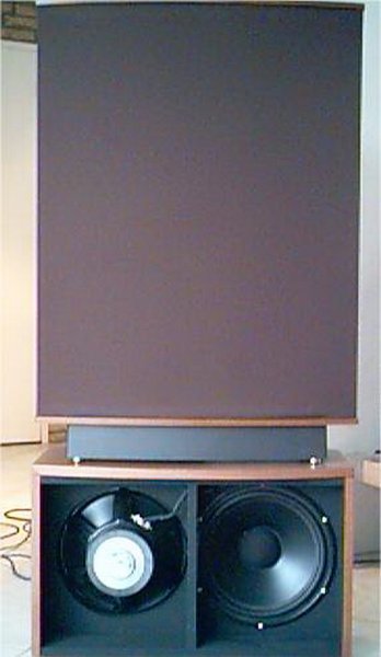

Without seeing behind the cloth, I'm not exactly certain if it's just a simple dipole with sides on it or anything different. Could you share pictures with the grill off when you pull the woofer?

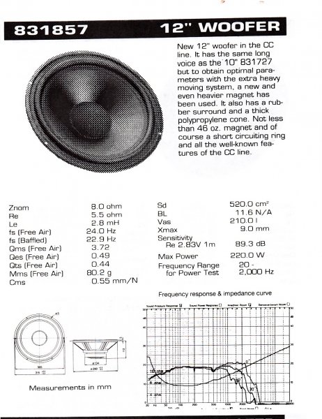

Hi Mark,
Thank you for your prompt reply. The Peerless 831812 has been discontinued for a long time and the suggested replacements are the 831857 and 830500, they are out of production too. I checked my Peerless catalogs and found data for the 831857 only, please see attachment. The subs have H-frame enclosures, these subs need a 6dB/octave boost because they are dipoles. Acoustic Elegance is a speaker company that has taken over Nick Mcinney's design after his death, the fantastic Lambda 8? SB12. But AE speakers' close equivalent, the Dipole 12-D8's price is outside my range at $339 a piece. [fs is high]

Hi Horacio,
I knew Nick and have known the owner of Acoustic Elegance for almost 20 years now, and am one of the highest volume customers/users of their custom drivers. The drivers made now are significantly more advanced and higher in build quality to the concepts that Nick brought to market years ago. While the massive top plate on the underhung driver, full copper sleeve, and many custom assembled parts push it past the budget driver realm, the low distortion and dynamic linearity is far superior to the Peerless alternates. In the H frame design you would actually find the Dipole 12 to have much better extension requiring less overall correction than the Peerless drivers. The Fs is insignificantly higher vs the greatly increased sensitivity due to the better matched Q for the H-Frame, which requires less severe correction for flat response.
John of Acoustic Elegance still offers an SB12, but a better match for the open baffle use would be the IB12AU. This gives you the full copper sleeve and the same maximum travel as the Dipole 12, while the Q of 0.51 and Fs of 24Hz is functionally extremely close to the Peerless woofers and will be dramatically better performers for $220 less for the pair.
Next up would be a suggestion that would require more power but offer more maximum output in the Dayton Ultimax 12. The Fs is a little higher, but the associated higher Q will make up for it. You could also use the Dayton Reference HF 12, but the only reason to choose it over the Ulitmax is for the $60 savings on the pair as it still has a bit too much motor strength for dipole use and will require more gain/boost from the crossover box.
If you're using them with Quad's, I'd e-mail John Janowitz of AE speakers and go for the IB12AU or something similarly suited for the use that John can whip up.

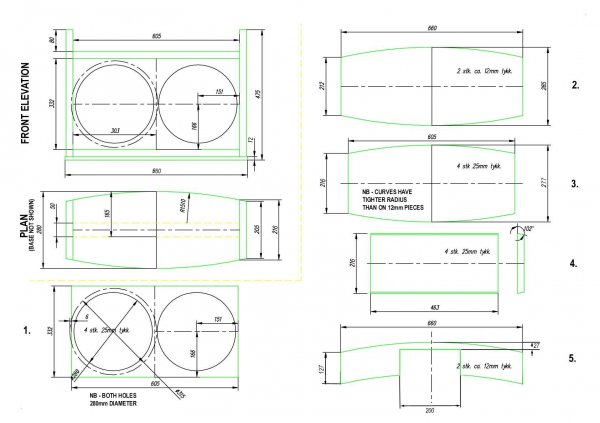

Hi Mark,
John kindly simulated a large open baffle that gave me an idea of what I may have in the H baffle design. He says that the Dipole12-D16 would be the best possible option. The plans that I have for the cabinets are an exact copy of the Gradient SW-63 enclosures but I am not sure if they would be a good match for the 12D-16s, it would be great if they can fit that design.
Attached are the plans for the cabinets.
Best regards,
Horacio

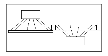

Hi Horacio,
When we first started discussing, I forgot that these subwoofers had the pair of 12" woofers each. The plans give John what is needed to model up the woofers, where the H-Baffle is relatively straight forward to model. John recommended the D16 version so you can connect all voice coils in parallel for a 4 Ohm nominal load per subwoofer. The parameters and frequency response between the D8 or D16 versions will be the same; it's just a matter of matching load to your amplifier in this case. If for some reason you wanted an 8 Ohm load, the D8 version could be wired with the dual VC in series and the woofers in parallel.
The budget option of the IB series would then give you options of the IB12AU-8 or IB12HT-8. The AU version will be more efficient in the upper bass, where the HT version will be less efficient in the upper bass but have more low frequency extension. The HT is essentially a heavier version of the AU, as you can see the Re and BL of each version is nearly identical.
